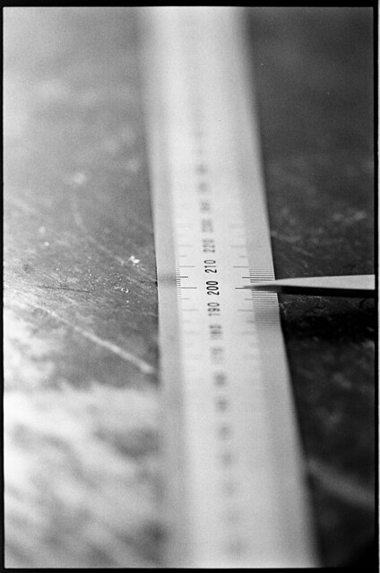

Do you have a ruler or something? Shoot that at a 45 degree angle, and pay close attention to where you focus.
On this shot, I focused right where the 200mm line is. I placed the scissor tip there to remind myself in case I forgot.
08031111 by J E, on Flickr
To me, the 205mm line looks sharper than the 200mm line... So, it looks like my lens is back-focusing by 5mm... (Probably more like 3mm, judging by the smaller lines.)
