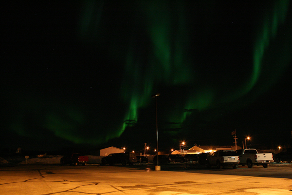

Here is a pic I took the other night you might enjoy along with yours.
Cool shot there! I just moved up to Yellowknife a couple months ago.
My pic was from this past Saturday night, the aurora was pretty intense!
