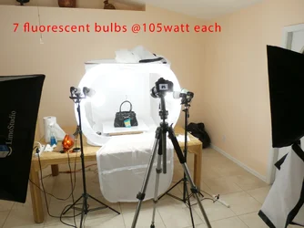

Something is not quite right. Take a look at my set up. I am using Six 105 watt fluorescent lights in front of the subject, and one in the back behind the tent. I'm using the 18-55 lens which should be sharp.
I still can get nowhere near 1/125, my images are very dark. I'm standing about 5 feet back from subject (the bag) and trying to use f8 or f11 100 ISO at 1/125.
Can anyone see what is wrong with this set up? Is it possible there's not enough light? I can't imagine more light.

Ah! I'm using small size pictures, I do not know about focus assist on a D3300 i will look it up. I will try a few pics with higher ISO, but a professional photographer said that for bags i needed 100 ISO
BTW
both manual focus and AFS give me the same pictures sharpness wise. I am trying to say that it's not my eyes or that I am focusing badly in manual mode.
I tried to crank up ISO to 200 400 800 1600, now the pictures are all grainy

No, you don't need 100 iso. You should be able to shoot at up to 1600 iso on a d3200 with little to no noise reduction, up to 3200 with noise reduction and still get very usable images.
0.5 sec shutter speed ?
you may be getting some shutter flap
Try upping your Shutter speed to 1/125 minimum
or try "Exposure Delay" as the d3x00 and d5x00 series do not have MUP
1/125 gave me a black jpeg and a black raw file.
