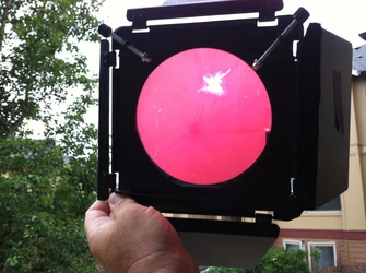

One umbrella, one gel, one reflector, girl's portrait
Here is an iPhone snap of the actual the gel...I got this gel USED, back in 1987 (!!!!) from a theatre lighting rental place...it was a "junker" back then. I cut it down and deliberately put the burned-off "white spot" off-center, and trimmed it to fit the diffuser-holder so that the white,slightly-hotter spot area would be off-center...as you might be able to see, the gel has faded from use...it's not perfectly even in density. $Gel from 1987.webp It almost broke my heart to cut up the old warhorse, but these people needed these shots FAST, for an 8 AM departure to the beauty pageant the very next MORNING, so I wanted to create SOOC images that would be ready to go as soon as I could get home and download the card to my Mac, without me having to do ANY post work, whatsoever. It might be a bit hokey, but I learned to use gels back in the 1980's, and I am NOT a very good post-processor and fake-background-creator in PS...
As you can see, the white area is where the gel HAD been used, since 1987, on a Speedotron M-11 head, with its exposed 150-Watt, HOT quartz lamp having caused the white damage, and having faded the gel...I cut it so that the darker, less-faded periphery would give me a bit of a built-in gradient, and so that one part would allow more "white light" thru. Not much, but "enough" to make a perfect,lighter spot, which I could aim behind the girl.
Nice work on the background gradient. Does the background light have a modeling light so you could place the white patch, or do you just know how it's going to come out?
I love your ingenious use of the worn out gel!
Very cool Derrel. Thank you for posting the diagram. That is a lot of information there to learn from (and I've got a lot of learning to do). Stupid question: the background color is just from a gel rather than a colored background? Why a gray background rather than white if you are going to project a color onto it?
Well, they HAD A BIG, wall-mounted projection screen for their projection television setup right THERE, already pulled down!!! So...rather than set up my OWN backdrop stands and crossbar, I left those in the back of my vehicle and used THEIR background, and it was light gray!!! So, it was a matter of convenience, and expedience...they already had a PERFECTLY SMOOTH, LOVELY very light,almost grayish backdrop screen right there on the liviing room's back wall! DOAH!!!!! How handy is THAT!?
In close confines like this, blasting a gel onto a WHITE screen means more chance of blow-back or "wrap"; in a confined shooting area, using a white background and a lighter colored gel means a LOT MORE light is reflected, and the color of the gel looks lighter in the photos; on gray, the color will be a bit more-saturated; when aiming the same light,m same gel, same Watt-seconds of flash power at a black screen, the color of the backdrop in the photo will be darker, more-saturated pink.
Same goes with other gels: take the same gel, same light unit, same flash power, same light positioning, same camera settings, and then 1) aim it at a white seamless, 2) then a thunder gray seamless, then 3) black seamless paper, and there will be three, significantly-different densities of background color. Assuming that ALL other variables are kept constant. Speedotron Brown line lights do NOT have the power-adjustment capabilities that my Black Line power packs have--they have NO variable, dial-down power. In close-confines like this smallish living room, shooting a gel onto a pure white paper leads to a LOT of "blow-back", and can, and often does, create a colored bit of light that actually comes back and hits the subjects hair and shoulders. THis can look neat...or horrible. Less-reflective material, like black velvet or black felt, ABSORBS MOST of the light that hits it, and does NOT send gel-colored light all over the shooting area. Gray is somewhere in-between.
If you want to get a REALLY deep, saturated background using any of the "pastel gels", like yellow, or pink, or baby blue, then Brown Line lights and packs are a terrible choice when shooting onto WHITE backgrounds. The relationship between the background light's REFLECTED LIGHT reading at the subject's BACK-of-the head in relation to the INCIDENT LIGHT METER exposure of the person, determines the exact background density or "color". Brown Line packs do not allow a huge variety of flash power output, so, in a real,practical sense, I seldom EVER want to shoot colored gels at a pure-white screen if I am lighting the backdrop with a Brown Line head....I will instead use my 405 or 805 Black Line packs to give a teensie-tiny say 25 Watt-second or 50 Watt-second squirt of flash,and then have that paired up with 200 to 600 Watt-seconds of main light.
Yes, the Speedotron Brown Line M11 light had its standard, stock 150-Watt quartz-halogen bulb in it, and the 4-way barn doors were "trimmed" so as to create a gradient fall-off at the top and bottom, and I placed the white spot of the gel so one area would be less-dense, and used the built-in fading on the old gel PLUS the barn doors to create a gradient. For the past eight years,I have been using a Nikon D2x and a Canon 5D classic, both of which have small, craptastic LCD screens...on the D3x, I now have a fine-quality, 3-inch 920,000 pixel LCD for review, so the last two weeks have been an eye-opener...I can now SEE what I am getting, in the field, to a much better degree than I have been able to before.
