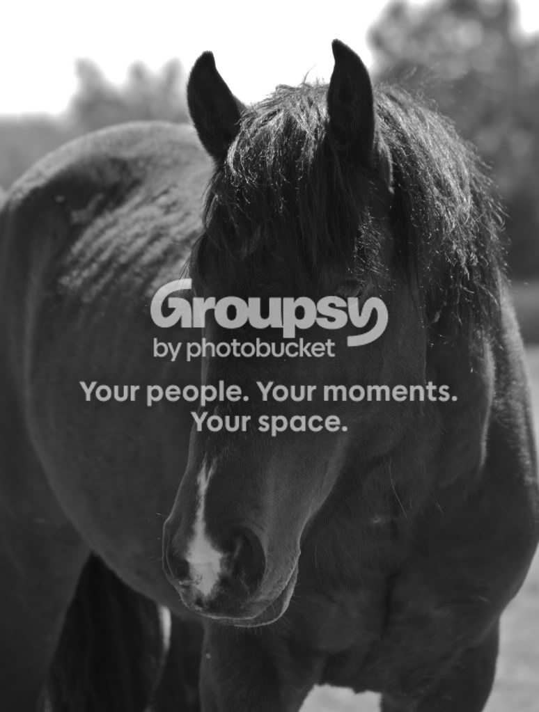

Thank you all so much, this is incredibly informative. So if I get the background wrong, I can always try and put it in B&W and see if it works better with some contrasting?
On your advice I tried some B&W, which I'll post below.

Here's the shots I've converted to B&W:
Original pic from 1st page and now similar image(shot just after the 1st) in B&W , side by side.

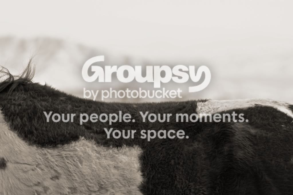

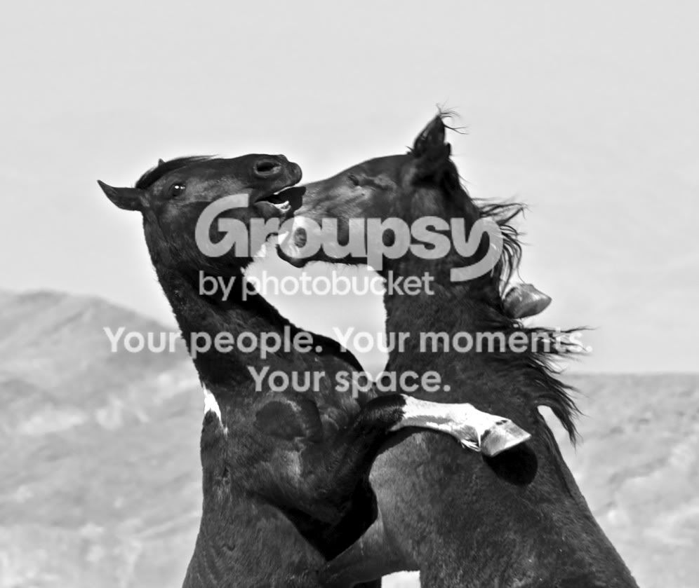

A couple more picture with bad backgrounds I've converted to B&W
I kept the mountains in this one as it seemed to follow the curve of the back and used some gave it some warmth.
