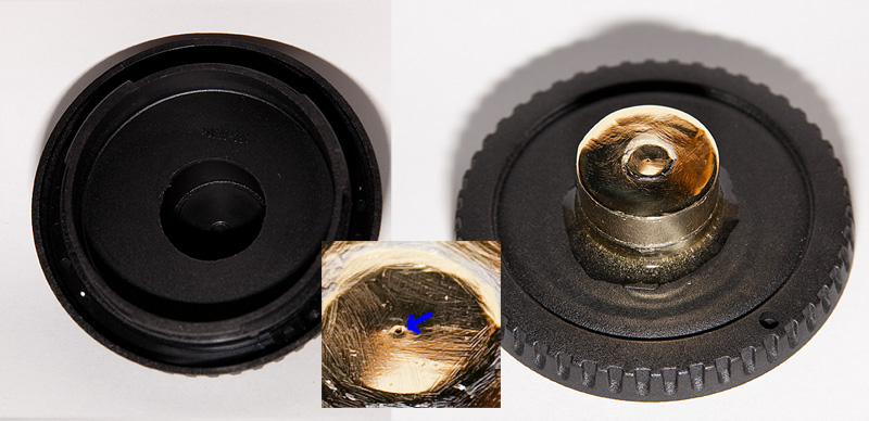

I made a new pin hole lens from the camera body cap. I used 1" brass tubing to move the aperture farther out to get a full frame image, rather than the circular image from before. http://www.thephotoforum.com/forum/photography-beginners-forum-photo-gallery/192321-pinholio.html
The metal for the pinhole is 1/30th of a millimeter. It is very difficult getting a perfect, clean hole. I am very happy with the results. With a little post work, I can see the creative possible uses for this "lens". They look old and Polaroidy. I plan on experimenting with the pin hole and a flash and see what that does. The following images are merely test shots to see the qualities of the lens. I forgot my tripod at work, so I was restricted to what I could rest my camera on. Aiming is hit and miss as well, as you have no preview to work with. It is literally point, shoot, and hope for the best.

Here a quick and dirty of Pinholio.
I think it's fairly self explainatory, but if you have a question...

dyyylan, apparently the farther out your pin hole is, the larger it can be. The hole diameter should be 1/100 of the lens length. That means the closer you get, the smaller the hole has to be. Also, the circular vignetting wasn't caused by my original hole in the body cap being too close, it was caused by the thickness of the body cap.
My experiment now deals with, is my current pin hole too small or too large for it's length, and is the hole too irregular in shape. I will apply a small amount of the black paint to the hole, to hopefully help "even" it out and make it smaller and see what that does.
