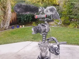

Here's my setup with a $30 Kamerar hot shoe extension on top of the camera to hold my mic, top handle and recorder:
Good luck,
Bill
My video setup.
Rode Shotgun mic
Sennheiser wireless kit
elvid lcd screen
85mm lens there but most of the time I use a 35mm IS USM lens or a 50mm USM lens.
