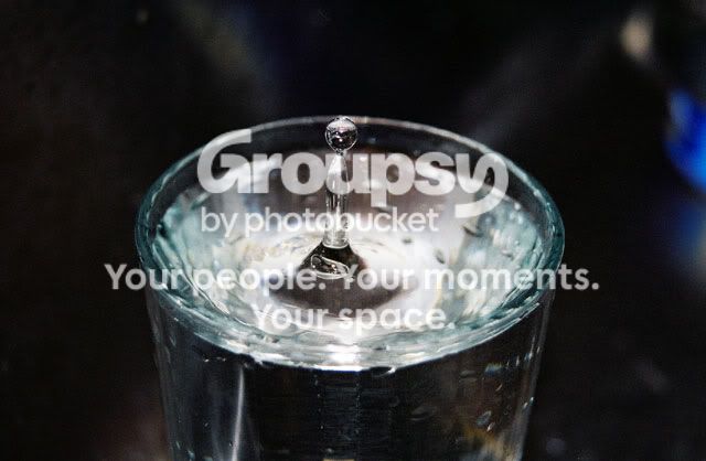

ANd here is the best picture i got out of the second batch

What do you mean by didn't come out? Are they not what you expected or is there no picture at all....and if so...are the negatives clear or solid?
the negatives are clear, like the film was never exposed this is color film also

If it were happening randomly through the whole roll of film, I'd say that there's a problem with your shutter.
Were you using a flash with the shots that didn't turn out?
Never exposed or not exposed for long enough? You've used a fast shutter there, is there a chance it was too fast? It's odd that on both rolls the same 12 are giving you problems. I have no idea as to what would cause that, other than a lens cap still being on. I'd be tempted to e-mail Nikon and/or take it back to the shop for them to look at.

i know the cap was off, and it is possible that it was to fast, but even the pictures i took in the same settings, with out a flash came out with something. Not good, but there was something there.
That is what concerned me is that it was basically the same group from each roll of film, I will probably go back to the shop i got it tonight or tomorrow, and see what they have to say

It seems that you were shooting inside, judging by your last picture, and I think the pictures may have been underexposed so that no image could be seen.
I will take a guess. If you look really close at the negatives, there are very faint bits of images. These are severely underexposed. If the flash was not working, i.e not turned on or something. The camera was exposing for the flash. I would say it wasn't iso, since it has the reader for the film, and it was, again I'm guessing, set for one of the automatic settings, so you weren't reading the wrong meter readings. Other than that, shoot a roll outside and see what you get, then if something is still wrong, take it to the camera store.

Yeah, i was playing with it in SHutter Priority mode. I am going through 1 more roll of film, in Good lighting and going to test this. I did look at the negatives very closely before i even posted, and could not see anything at all.

When shooting in shutter priority mode, what apertures were you getting? Is it possible that you set the shutter way to fast for the light level...and that the lens could not open the aperture any wider to accommodate the fast shutter?
Were you using a flash? The camera will have a flash sync speed...which is the fastest shutter speed you can use with a flash...Usually from 1/90 to 1/125. If the shutter is set any faster than this...the flash will fire while the shutter is only partially open...however this usually results in half of the photo being exposed and half being dark.
I am pretty sure i was using the flash (built in flash for the camera) for all the shots. And yes i did have the shutter speed pretty high, I also had all the lights on in the room, so there was Some light coming in externally. I honestly dont remember what the apertures were, like i said i was really just screwing around and not paying attention to that. This last roll I am on I am paying more attention to everything.
