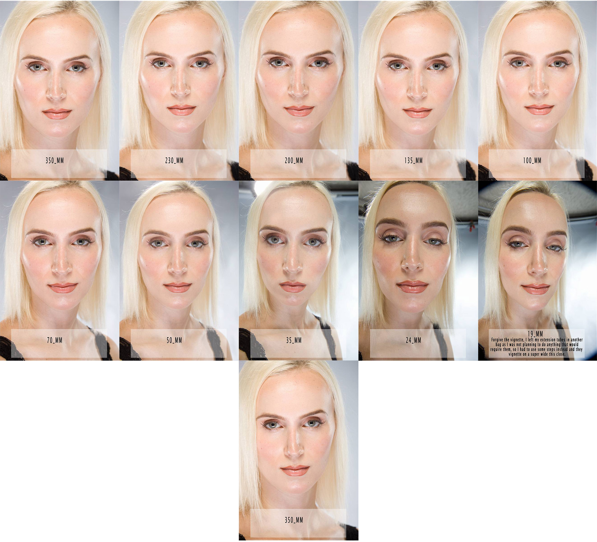

1) Since my camera is a crop sensor, is 50mm a good focal length for portraits? I heard that it'll be a 75mm since it's on crop sensor.
You heard one of the common myths. Focal length is Focal length period. Sensor size does not change focal length. A 50mm is a 50 mm. What you are getting on a crop sensor is the field of view that falls on the sensor is approximately equivalent to what a 75mm lens would produce.
Personally I prefer the 85 to 100mm range for portraits on either a FF or a crop for the particular characteristics of that range.
Various focal lengths shooting the same subject filling the frame as close to the same as possible.

gryphonslair99 is correct, the crop sensor does not make a 50mm lens a 75mm lens, it just gives you the same field of view as a 75mm lens on an FX camera. You will not get the exact same picture taking the same image with a 50mm on a crop sensor as 75mm on a full frame sensor. As he illustrated, it is more like cropping the image down after it is shot.

This is a really nice and informative set.
Very nice example of how perspective changes distortion, independent of the lens used.
The shown efffect is only dependent on the distance between subject and camera, not upon the lens used.
That said: A longer focal length means of course a wider subject distance to fill the frame
Very nice example of how perspective changes distortion, independent of the lens used. The shown efffect is only dependent on the distance between subject and camera, not upon the lens used.
Actually the effect remains constant, the ability of the observer to detect the difference is dependent on the distance between subject and camera.
