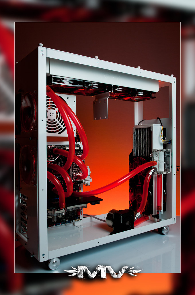

heres an example of the "best" shot i can get (i didnt have the 2nd side strobe at the time of this shot)

what do i need to do to get the object to look smaller and the background to look bigger.... dont know if what im saying makes sense...
im using a 24-70 f2.8 for my shots, and i can find almost all kinds of lens (from friends). what do you suggest?
It seems that you already know your problem...space.
To make the background seem bigger, you need to use a longer focal length (narrower field of view). But to do that, and still get your subject in frame, you'll have to move back....so you need space.
Another option would be to use a larger backdrop.
