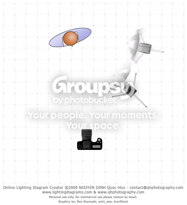

I used the dark of the night as my background, and lit myself with two SB600's in shoot through umbrella's. Both camera right, one at a 15 or so degree angle to the camera lens plane (from me to the camera), and the other at almost a ninety degree for fill. Both triggered by an SU800 on camera. Edited in Lightroom 3, Photoshop CS5, and Portrait Professional (just some lightening of the eyes and smoothing of the skin. Nothing too crazy).

Thank you. And what is the easiest way to lessen the shadows? A reflector, or just move my key light?

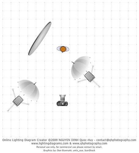

I think a reflector 90 camera left would have worked.
Also, do you think a back light pointed at him would help with some added separation?
Something like...
key light 45 degree camers right
reflector 45 degree camera left
backlight for separation

Definitely would have gone for a reflector on the shadow side - down fairly low would have helped out with that shadow under your chin and just to define slightly the dark side of your head and your right ear.

I think this is a fantastic shot. I'm a relative newbie and really know nothing about key lighting, etc., so I enjoy seeing the schematics of these shots to try to learn how this is done.

Not to hijack, but I'm with jwbryson... I'm just starting to use strobes for portraits and these lighting diagrams everyone is putting up and explaining are a great way to learn lighting setups.
