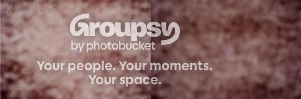

Holy lord was it dirty. I did some excessively funky editing on these to make the spots show up... can you tell which one is the cleaned one!?
Jake
P.S., I realize there's a super light streak in the top right and about one speck left, but those are easily edited out. The streak is not noticeable unless I mess with the settings to make the image HORRIBLE. So I think I'll chock it up as a win.
EDIT: I just went and swabbed once more, and the streak is gone, and so is that dot!! Completely Clean!!!!
P.S.S. I found like three spots... OH NO! Haha, but really, I can edit those out in a second. I don't even want to count how many were there in the beginning.

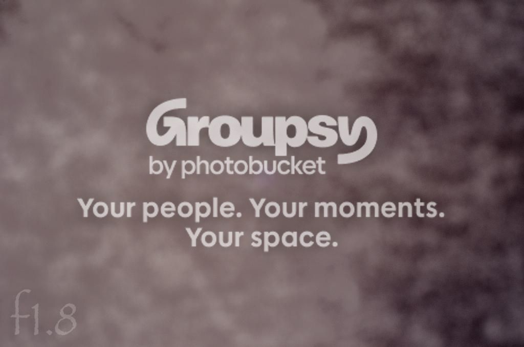

what'd you use. My sensor looks about the same right now. I'll have to post the white wall shot i took last night. Spots show up when im shooting closer to f/11 throughout the image. very annoys.
I used the arctic butterfly for a few swipes, and that got a bunch off. But there were some welded spots... so I used the #2 sensor swabs, and ended up using four. Each of the first three left a bit of residue (I think I may have pressed too hard), but by the fourth I got it completely clean. Then arctic butterflied once more to ditch a stray hair.

here's my sensor:
This is a refurb'd D600. I noticed spots the day I got it.
Hey I know it sucks going with out the cam if you don't have a second one but I would take full advantage of Nikons Replacement parts. Be nice if they replaced it with the 610 but I doubt that. Don't let nikon get away with it, hold them accountable and get a new shutter replacement.
hmm. I haven't done this yet. suppose to use a garden hose right
It's a LOT easier to see the dirt if you shoot something white at about f/11 or so. Overexpose a couple of stops so the meter doesn't turn it gray. Ignore the focus, don't worry about motion blur. I just use a white browser window on my monitor.
