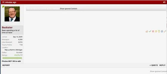

He posted the following in the same thread where I posted the video I made that proves his comments above are FOS:
Patch tool can work pretty fast on this, so can the dodge tool set at fairly low density and low flow and sort of "painting on" the darker areas and lightening them up.
I sometimes go into PS and use a soft-edged brush and use the clone tool at low flow and about 85% density to clone over the under-eye area, sampling from the area right below; you need to keep the density (opacity) below 100% or it looks faked.
I don't think we've ever actually seen him post before and after results of him showing how great he thinks his technique works, especially in comparison to FS though, so keep that in mind. Derrel's often just plain right because he says he is. If you prove him wrong, he puts you on ignore, as seen above.
