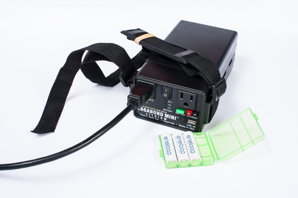

I get over 600 pops on a studio light from this cheap but powerful lithium battery on photoshoots and don't have to be close to a vehicle. Google "Paul Buff Vagabond Mini".
I took a pic of it using it last night heh
That inverter should do just fine as it's a pure sine-wave model, but at $269, plus batteries and chargers, I suspect that there are cheaper options out there.
Not to mention that a car battery is freakin' heavy. I vote for the Vagabond Mini.
The Vagabond Mini product I posted is $239 and has 2 AC outlets and a USB. I run my lights, tethered laptop, and charge my cell phone when on location. And don't need to be next to a vehicle with my lightstands.
Here is what my set up is rated at per charge:
typically 400 to 500 shots per charge with 640 total Ws connected
typically 200 to 250 shots per charge with 1280 total Ws connected
battery can be fully discharged and recharged approximately 500 times before losing 30% of its capacity (even longer life when recharged before it is completely discharge)

Well its actually the same size as the vagabond 2 bag. Not all 12v deep cycle batteries are huge. Some are actually less than 20lbs. This is what I was thinking of making except with a smaller battery because I will only be using one 250ws flash.
the vagabond III converter and lithium battery set-up is much smaller than that pic and weighs a couple of pounds at most
