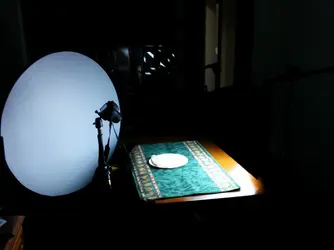

Ok I did my best to follow your suggestions and have attached what I shot this evening.
I obviously need to learn how to use my reflector better - big shadows under the bottom of the plate.
There is some juice on the side of the plate and I tried to remove it with paper towels but it really only smudged it.
The kind of advice you gave was very helpful and thank you.
I shot the photo and all f stop up to f 11 and did one at f 22,

The photo of the setup only shows props and not the food.

I would say that is a big improvement already. The shadow under the plate doesn't bother me too much, but you could easily soften it by adding some small pieces of white card to act as reflectors much closer. For work like this, you will often wind up using a number of small reflectors to control individual shadows as opposed to one large one, the way you would in portraiture.

I commented on your other thread about not knowing where the camera is supposed to be, but this is clearer.
I have to say that the reflector is probably not contributing to the lighting as much as you think it is. You've got it almost the same distance from the subject, maybe a little more, as your actual light, but you have to realize that the light from the reflector, by the time it reaches the reflector and back to the food, has gone at least three times as far as the light from you primary source, so it's only 1/9 the intensity (inverse square rule.) It's going to be even less than that, actually, because the primary light is not facing the reflector, so the reflector is only catching spill light.
You know, if you only have the one light, you might want to try putting it low in front of the table, firing up, hidden, as it were, and hang the reflector over the food, such that the reflector produces all the light seen by the camera. Not sure you'd get what you're looking for, but it might be worth a try. Maybe behind the table instead of in front. Just thinking out loud......
Aside from the lighting, you're seeing a depth-of-field issue, which I'm not sure how to tell you to address, other than stopping down the aperture or moving the camera back. Maybe look at some of the DOF calculator pages you can find with a little Googling, and setting your focus at a distance that gets your nearest and farthest sections within the "focused" selection of the DOF.

Thanks and you are correct that the reflector is doing close to zero, and I had thought of using the silver side, but will try your idea first.
I am happy with the D3300 but you can't check the DOF through the viewfinder.
I have about nine pictures of the above all shot at different f stops.
My lens is an Nikkor 35mm 1:1.8G so moving further away is not really an option. Well it is, but the food would be further away. ;-)

I could buy some small white cards but how do you hold them in place?

Other bits of card, Blue-Tac, whatever you have. Use pieces of foam-core and then cut "stands" for them in the same manner as a desktop picture frame, and attach with hot glue.
With respect to your question on colour temperature and dimmers, yes, it probably will. So what? Correct in post.
