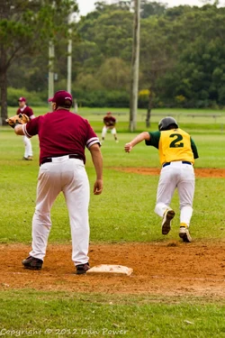

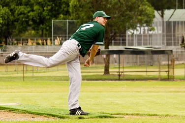

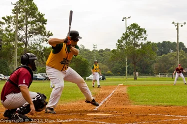

Here's some examples from the first game I went to:
So what I'm mainly not happy with are the cluttered backgrounds, which I think are partly to do with the kit lens only going to around 5 or 5.6 at these lengths and simply the location of the field... I can't really move the buildings in the first two shots and the fencing isn't going anywhere either. If I could blur these out I think they'd come up better, so tonight I'm going to learn to blur backgrounds in PS. It looks relatively easy but I've never tried it so tonight's goal is to learn.
Other than that, what do you think I should be looking at working on next game?
Thanks heaps guys.
Backgrounds at baseball games is always going to present a bit of the problem, it's just the nature of the park setup. If you can, try shooting through the fence behind the catcher straight on at the pitcher, it also gives you a cleaner look at the bases, as you mentioned, but you can also use longer lenses through the fence. Don't start using photoshop to fix the images, learn how to clean the backgrounds up in the camera, it will take some time, but there is always a clean background somewhere, just means you'll have to really look for it. You were a little late on some of the action and well, but that comes with practice and understanding more of the game. Baseball is a waiting game, some days you'll get action and the other 99% of the time very little will happen, try not to fall asleep while waiting. Enjoy being there and keep at it. You're on the right track.
Thanks for that, the backgrounds have been a real PITA for me.... every time I get something decent, there's something wildly distracting in the background. I got a shot yesterday of a guy taking a catch, you could see the ball landing in his glove... was really happy with it except there's two fat shipping containers in the background and they ruined it :(
I was mainly looking at learning background blurring in PS to fix the ones I already have, not for the future.. longer lenses are down the track so I have to learn to deal with what I have now at least for the next month or two. I was looking at the 70-200 either canon f/4 or Sigma f/2.8 but they're 50mm shorter than what I have now, so I've actually been looking at the canon 100-400 4.5-5.6L but I'm not really sure at the moment. I can hire both of the canon lenses though so I think I'll try both, thing is I shoot mainly snow sport so baseball isn't the greatest test of the lenses for me LOL :)

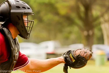

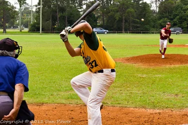

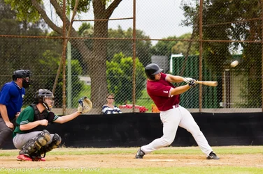

Here's some from the second game I went to:
I think I got a few better positions at this one and the background was a bit nicer, the colours seemed richer at this ground too. #4 would have been better if I'd been on the umpire's left shoulder... I can't really get directly behind him, the scorers at most grounds sit there so I can't get in their way. That's about as close to straight-on as I can get to the pitcher..
