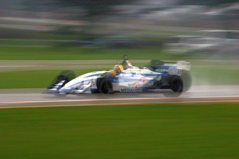

When I first shot this, I thought it was the focus jumping. I read more and I believe it's the IS shifting while the shutter is open. Double exposure is pretty impossible, as it's a Canon 10-D with a 70-200 IS-USM F 2.8
The car in the background is in a different part of the frame, as it would be while you panned with the subject, so I would go with double exposure if asked, and given no other information. Don't really know how it would do that to you, though.
The two exposures of the subject are reasonably sharp, no motion blur except what was intended for the wheels, and there's no blur between the two positions, so although I don't know how quickly the IS system adjusts its elements, it would have to be DANG quick to achieve that!
