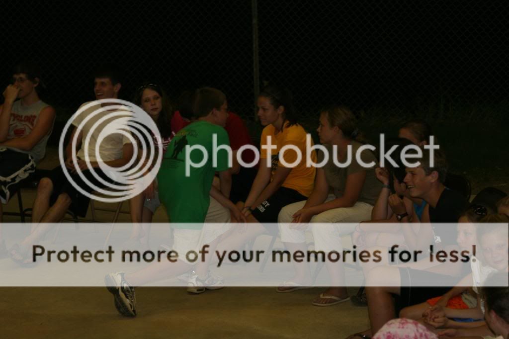

I asked the same question a month or two ago. My lenses are not that great, but for what I am doing, (learning;)) they work fine... except in low light situations like this:
It seemed bright enough, but the lens just wouldn't let enough light in which caused my shutter speed to slow down, which led to blurry people.
The point is, while learning, I try not to use it, simply because I think it helps me see when I need to use it. As I get more creative, like the pictures from Sw1tch, I hope I will have the forethought to use them and use them correctly. I have plans to get a flash gun soon to get away from the onboard flash. Then, later, get better lenses. :) Maybe one day, I'll be good enough to know when to use it and more importantly, how to use it creatively.
Crosby, your situation was just lack of sheer power. What you can do though is use the 28mm, get in close and wide and drag the shutter, then the onboard is only freezing the subject while the ambient exposes over a little longer.
If you can't do that or are too timid, panning might be worth a shot. Also, there's nothing wrong with shooting at ISO 1600 or 3200, I sometimes shoot at high ISO's when using strobe so they don't have to work so hard.
EDIT: You were shooting at only ISO 400 at 1/60th of a second. bring that 2nd one up a stop, so you'd be at 1/60th ISO 800, and push the ISO to 1600, that's 1/125th, that's hand holdable and will also freeze action if you pan well, ISO 1600 on the 30D is pretty clean, and it's not like these are going to be printed at 12x18 anyway.
