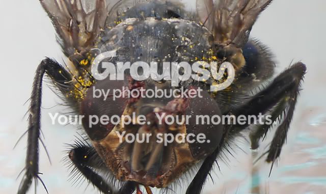

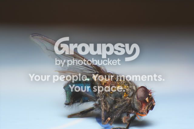

I get more than 1:1 using my 18-55mm lens. Use your zoom. Here's a couple examples of an ordinary housefly...
You're right, I've done that with my other lens. Those are very nice by the way, thanks.
