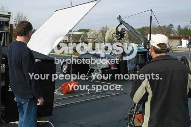

Here's a shot of a 12' x 12' diffuser in action. This was on a commercial shoot I directed.

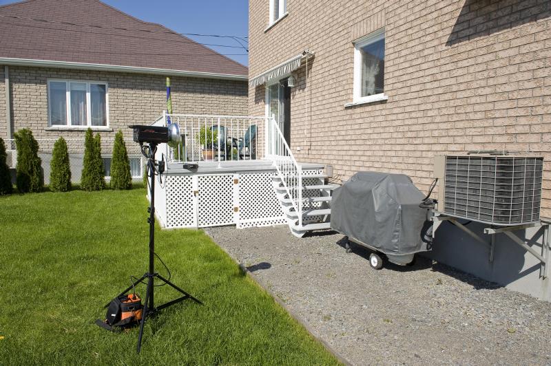

The best thing to do, the one that gives you the most options would have been to blast them with light that can overpower the sun and stop down the lens to F/16 to F/22 if needed or increase shutter speeds. That way YOU have control over the lighting, and not the sun.
Power aside, the smart thing to do is do what the pro photographer did... get them in the shade, and fast. ;)
Having control over the light is what it is all about and one of the reasons I invested in a nice 1000 W/s pro studio head and a portable battery pack!
When you can take this at F/9, ISO 100 and 1/200th:
Then up the shutter speed to your maximum sync speed (I could have gone all the way to 1/8000th using a trick only Nikon owners can use) and smallest aperture to F/22, ISO 100 and 1/250th and get this:
... and then blast away from 12 feet away with a powerful light source (AA battery powered strobes are not going to cut it, sorry) and still get 1.5-2 stops over exposed to get this:
...then you have control over the ambient on even the brightest of days... and not the other way around. ;)
Then you can shoot literally anywhere and not worry about even the brightest of days or no trees or shaded areas (like in the case of beaches for example). The nice thing about the "more power" solution is that it underexposes the skies and backgrounds nicely making clouds more dramatic or the skies a nice dark deep blue without a CPF.
