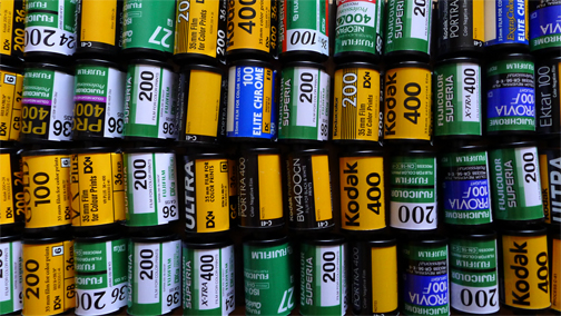

Hi,
I'm new to photography and have recently been given a Kodak Colorsnap 35.
Could someone possibly link me to a film that would fit the camera. I know I need a 35mm but will any 35mm fit?
Thanks

Your camera will use any standard cassette 35mm film.
Joe
Yes, 135 format color or B&W film, ISO 100,200, or 400 would be best.
