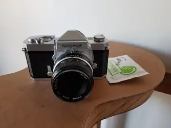

Its finally arrived, no thanks to Australia Post :angry: It only took 2 weeks to get from Sydney to North QLD, and 3 days to get from the sorting center in my small city to my house, but it's here.
Everything seems to work, the viewfinder has a bit of dust in it, but not too bad. And as a bonus, I got a free packet of soup! :confused-55:
Now to play around with it for a few hours to make sure the timing on the shutter gets up to speed (if it isnt already) and load it up.
View finder dust is no worry, as long as the lens is clear it will take good pictures. However if the dust is thick black particles that may be from degraded and crumbling light seals which will need to be replaced. They are very easy to replace at home and can be had for <$10 USD on line. I consider it almost mandatory when buying a camera of this age but occasionally luck out and they are still good.
Check the mirror bumper which should be a soft foam seal on the front edge of where the mirror flips up. If you push down with your finger the seal should be somewhat spongy and come back to its natural position when released. If you come back with little black bits on your finger or its not soft to the touch its time for a fresh one. This one is a bit more important than the rear seals as it protects the mirror as it actuates. If the rear seals are not looking great either some black electrical tape over the gaps will ensure safe operation until you can get a fresh seal in there. The rear seals also have a U channel that the door sits in to help prevent light from getting in just by the shape of them.
