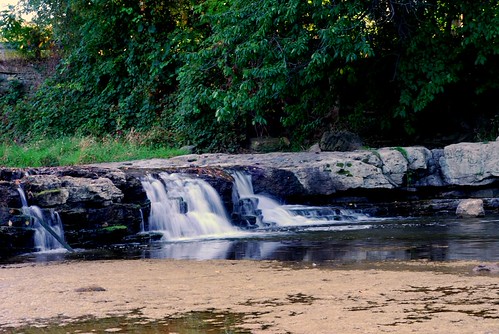

I got a decent effect with just 1/8 on a little water "trickle"... can't even call it a waterfall. It was very bright out that day and I don't have an ND filter...

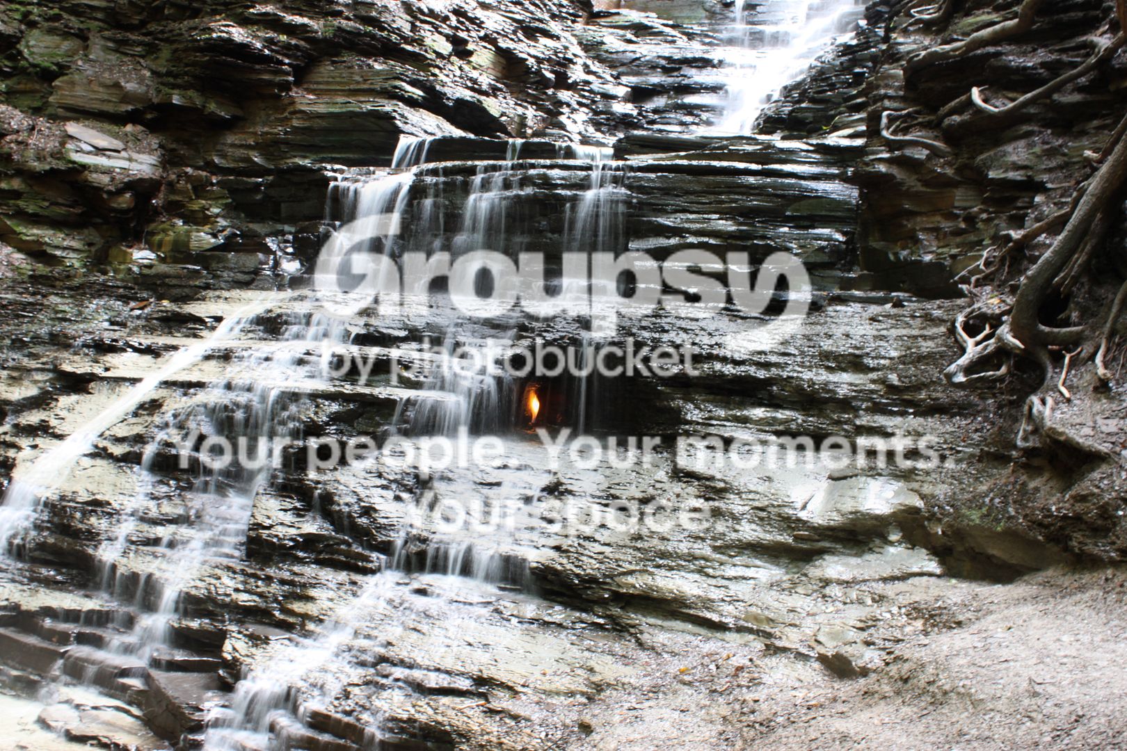

Is that a small fire in the middle of that waterfall??
Seriously, what the hell is going on in that picture?
***Beware: Nerdy comment ahead*****
It's either a bonfire for a Keebler elf or someone better call Frodo and tell him to bring that damn ring.
I don't know myself why that came into my head. I only have seen about 20 min of that movie, but it was my first thought. wow. sorry guys

As has been indicated in an earlier post, don't get fooled into thinking that to get silky water shots you have to shoot at 2 seconds or more. It depends a lot on how fast the water is flowing. Trickles/slow moving water you may need 2-3-4 seconds or more, but if you have a large waterfall with lots of water going over it, 1/10 could be as little as you need.
On an overcast day, or a shaded spot, you may get away with having the aperture closed down to f22, or something more appropriate may be the use of an ND8 filter that gives you 3 stops. Example from my flickr stream here
If however you are shooting where it is sunny, you need a serious ND Filter. I can't praise highly enough a B+W110 (ND1000) filter which gives 10 stops. Once again, Example here.
There is also such a thing as "overdoing" it with long exposures on fast moving water, to the point where you actually lose the detail of the water flow itself. You can see that happening in some areas of the first photo.

This was f/22 and 1.3 seconds. At iso 200
I also had a 1 stop ND filter on so that helped slow the shutter by 2 clicks. And a blue gradent(sp?) filter darling the sky but that got croped out.
(that's the eternal flame waterfall at Chestnut ridge park in western NY. It's a natural gas fissure that stays lit)
