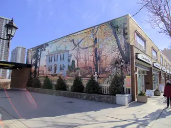

Since this is St. Patrick's day weekend, I thought I should include a picture of a pub. This pub happens to have one of the murals. Unfortunately, when photographed from across the street, the mural is blocked by a bench.
"P3160055.jpg"
"P3160055_jpg-rsz1640-C1.jpg"
- resized, no other adjustments
Partial EXIF
Date and time 2018-03-16 15:13 [I forgot to set DST, so actually the time should be 16:13:xx]
Program name: ASDK-00141
Pixel height 3888
Pixel width 5184
Color representation Uncalibrated [AdobeRGB -- all my pictures are re-encoded to sRGB by PaintShop Pro during output to the new JPEGs.]
F-number 1/6.3
Exposure time 1/250 sec.
ISO speed ISO-200
Exposure bias 0 step
Focal length 12 mm
Max aperture 3.64
Metering mode Center Weighted Average
35mm focal length 30
Exposure program Normal
This mural is the one in front of the pub.

"P3240002a-rsz1600-C1.JPG"
"Fox & Fiddle Pub"
Partial EXIF:
Date taken 2018-03-24 09:08
Program name ASDK-00141
Dimensions 5184,3888
F-stop f/9
Exposure time 1/500 sec.
ISO speed ISO-200
Focal length 15 mm
Max aperture 3.71
This is much better than the previous version. It can be argued that the lighting was better this time, but even taking account for that, the colour selection is much improved. Overall, there is no "blue cast" to this set of pictures.

John Kuna v. YiM1
This is a continuation of my test of the various colour choices in the YiM1 and also an update on my pictures of the "Village of Islington" murals. As I noted, the "Vivid" finish worked much better than the "Portrait" finish. I posted the "Vivid" set in:
"Yi Technology -- Yi-M1" (see #36)
As I wrote before, I am quite pleased with that set of pictures. They are "scouting" pictures where I am mainly interested in making a record of "what is there". In particular, I felt that due to the building orientations I would need to plan the time of day when lighting and shadows were optimal.
Lately I was checking the internet researching the artist (John Kuna). There was nothing in Wikipedia(yet) but I did eventually find articles about him, and also his own website.
On his website, there are pictures of a number of his works. What I found most interesting is that there is a strong similarity in the color rendering to what I got from the YiM1 in AdobeRGB and "Vivid" finish. Have a look and compare them. Certainly the pictures on his site are better, but the colour sets are very similar. You can see them at (his website):
"John Kuna Murals"
You'd think that by now I would have tried all the "relevant" feature combinations on this camera, but there are still a few to go.
I have found that the "Finishes" (Standard, Portrait, Vivid, Natural B&W, H Contrast B&W) can be used for video recording. I tested them all early in the Summer in Full HD with stabilization and they worked for short clips. I had intended to try longer clips in 2K later.
This Fall, I decided on a video project using the Yi "2K" (4:3) format with the "Vivid" finish. I had a number of video clips in the camera and decided to save them off and start the editing. I have just reviewed most of the clips, and unfortunately, not much turned out. It appears that the combination of "2K" and "Vivid" only works for a limited extent. Depending on the clip, most of them "failed" after around 40 sec. recording time. This varied with the subject matter. I think it probably has to do with the complexity of the images which varies for each frame. It is probably over-running a buffer used by the Codec.
Unfortunately, that means that the project (which I was looking forward to) is a bust.
I do think that it is probably possible to use the "Finishes" in Full HD. I will have to try a longer test clip to be sure.
