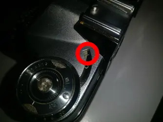

Last week I bought a Zenit-E from my local junk shop. Being new to film cameras, I knew a few things to check (winding mechanism, shutter etc.) and they were all right, but I neglected a few things. One of those was the Selenium Cell Light sensor - as far as I know mine doesn't work at all (see attached image - the white line should move when light varies, but mine stays put).
If anyone knows how I should best deal with this, or if I actually need it at all (alternative methods maybe), then please let me know in this thread.

Light meter doesn't work ? Most likely selenium is spent. Get hand held meter. Best and not to expensive used one would be Sekonic Studio Deluxe. No batteries and simple to use (however it looks complicated, it is not ). I use it in incident light mode, quick and reliable. Hollywood is using it even now, for shooting digital movies.

That's what I was going to suggest, get a hand held meter or try the Sunny 16 method. If the selenium meter isn't working I don't think it can be fixed. It would most likely not be worth putting money into it anyway.

Use sunny 16. There is also an accurate free phone app called light meter that works although it can be troublesome using out in the sun, hard to see the reading. You can practice with your light meter in the backyard while trying to guess your sunny 16 choices. With a little practice, you will be able to figure it out in short order.
