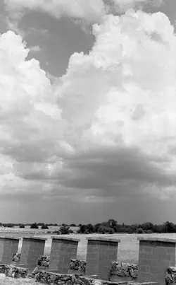

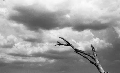

I shot a roll of 35mm and developed after the test pics from my new (used) Mamiya (posting those later). I think I let the developer get warmed up, because I developed these after the 120 film, and for exactly the same time. And I specifically remember not checking the temp before developing this roll. The negatives were VERY dark(at least two stops), and ... as it turns out, very grainy ... I'm almost certain it was the developer temp. But I found three that I liked. Here they are.
1)
2)
3)
P.S. These were shot with Ilford FP4 Plus 125 with a #25 red filter(LOL held over the lens by hand, the threads were too big :) )
P.P.S. These were cleaned with clone stamp, and added a touch of contrast & clarity in LR

The red filter gives that deep,dark black blue sky and puffy clouds! Yeah, the grain is pretty big and...grainy...you're probably right about overdevelopment if they were dark and also very grainy. Of course...you might have overexposed the bejeebers out of the film too for all we know!

Overly large grain can be brought out by too high a developer temp, by gross overexposure (sticky lens aperture for example...), or by over-agitating, or by developing for too long or with too strong a solution, or any combination of those things. I have no idea how you agitated, or what "room temperature" might be...it's late August and you are in Texas...room temp for all I know might be 85 or 90 degrees...

Are this picture of the same magnification ? I mean the same crop ? I mean they represent the same amount of negative area ? That's one. Second, how did you set the exposure ? On that roll do you have picture of the sky only ?
@timor ... Yes, these are all the the same magnification, no cropping, straights scans with a little cloning & contrast/clarity. Here's an untouched scan(pretty sure this was with a red #25 filter in front of the lens):
OK. So, it looks like you've got different size of grain in different frames. That cannot be attributed to development only, but to exposure. In frame #3 of the original post is something, what looks like uneven development. What was the method of light metering ?
