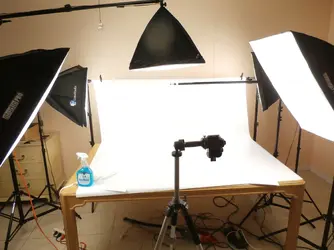

about 4 feet. And only about half of them were turned on. Hang on let me take a pic of my "most recent set up" I have changed this set up many times.
Here is current set up.
Softboxes 1 and 2 are pointed towards the white background, they contain 8 x 85watt bulbs (four each). They are both behind the subject.
Softboxes 3 and 4 contain seven x 85watts each. These softboxes have toggle switches, so i can turn bulbs on or off. These softboxes are normally on the side of the subject in front. I move these softboxes closer or farther away from the subject depending on the shot.
Softbox 5 contains 4 x 85watt bulbs and is directly above the subject. Most of the time this softbox is not active, because it causes reflections from above.
The subject is about 3 feet before the white backdrop. The white backdrop is matte PVC. All softboxes have at least 2 layers of diffusion inside.

Oh,
the boom you see in the middle has a fishing line attached, and keeps the bags upright
come Monday, everything you see here will be replaced by 4 strobes inside soft boxes. The question is? Where do i position strobes? what distance? do I aim them at the bag? Or at the ceiling?

I learnt that illuminating the backdrop makes it whiter. So i use light back there.
The top light is supposed to bring more texture to the bag. I have not noticed this. All it does for me is blows the bag handles out and gives them reflections.
The left and right side softboxes illuminate both sides of the bag equally, as well as the front of the bag.
Am i missing something?

As for diffusion, it's a white sateen textile placed inside the soft boxes. Angles I will have to measure exactly. The lights on the backdrop are bright, the others I can tone down.

Move you lights closer to the subject, that will soften the lighting. You will need to dial the power down. The angle of the lights determines the angle of reflection. Basic geometry. Lower the power of the overhead light so it adds a touch of fill. Understanding lighting ratios is just as important in product photography as in portrait work.
