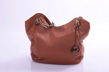

ok i put the camera in FLASH mode and this is what I got...it's a little better... still do not understand why the shadow is purple

Also ...how in the hell do you guys focus on the subject in the dark, can i turn on some cfl lights pointed at the bags to focus? The modeling lights on the strobes are a joke. I may as well light up a match it would give me more light
The documentation for your strobes should give the color temperature. Otherwise, just put it in Auto White Balance and move on. Two mouse clicks in virtually ANY editing software will set a white point and you're done.
