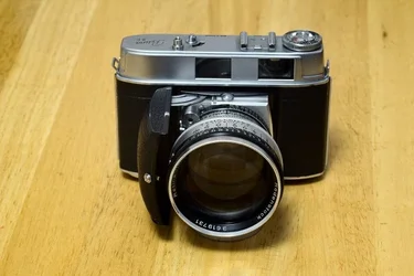

For accurate WB it's necessary to know the color temperature of the light source.
Here's a photo taken with the camera set to AWB:
Please explain how the camera was able to accurately measure the color temperature of the light source.
Joe
Joe
How do you think measurement of any color temperature is possible? How do you think we measure the color of stars?
For that matter, how is any whitebalance the "right one" or the "wrong one" if the only way to tell is to look at a known white source which, itself, is given an arbitrary "correct temperature"?
No. There's clearly a flaw in your factual claims somewhere.
