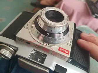

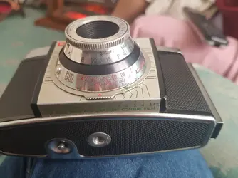

I've attached a picture of the bottom of the camera and the top.
What value would I need the red arrow at the bottom to show as that value obviously changes when I alter it to change the light conditions.

For your film, that red arrow needs to point to 200 as that is the speed of Colorplus 200.
The notch at the top needs to point to the weather condition of the day. On this camera you can ignore the EV number unless you complicate your life with a handheld light meter.

You need to set the ISO/ASA to 200 for the film you're using by lining up the red arrow at the bottom of the dial to 200. In your picture it's set at around 160 - change it so it lines up to 200.
Then go to the top of the dial and set it for the outdoor conditions using the pictograms (icons of a cloud, sun, etc.). As John M. says it shows the EV value which would be used if using a flash or a hand held meter.
Use the triangular notch and match that up to the appropriate outdoor weather icon. In the camera manual the example is set for bright sun - you can see the notch is set at the line that goes to the full sun icon/pictogram. In your picture it's set almost at partial sun but the line isn't quite matched to the notch.
That probably is a good starting point, to match the notch to the appropriate weather pictogram. I wondered what the black and white triangles were for, and in the manual it shows to use the black triangle/arrow if the subject is dark, and use the white triangle/arrow if the subject is light. You might need to figure out after your first roll if/when to reset that from the notch to the black or white triangles.

There are TWO rings there. One selects film speed & the other selects lighting conditions. The two can be moved together or they can be moved separately.
You need to find the release that allows them to be moved separately. It is probably that button on the film speed ring (press and hold while turning) or it might be elsewhere.

The camera manual calls it the 'serrated tongue' and it's at the bottom. (pg. 12) The rings are called 'distance ring' and 'light setting ring'. (pg. 5)
