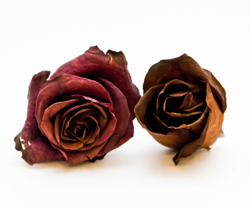

So I just got my 430EX II Speedlite. And I can already see a world of a difference when i take shots with it. I took this a few mins ago and would just like to see if "i'm getting it right" or if im even headed in the right direction.

It depends; in what direction do you want to go? What I notice about this image is that the background and exterior petals are well illuminated, but the centre is very dark. How did you position your flash for this shot? My thought is that were I do try this I would have the roses positioned so that they were vertical and bounced my flash off of the ceiling to get a more even lighting.

I think this is it here:
My thoughts are that it seems a little bit soft, I`m not a fan of the desaturated look either. It looks like you bounced the flash off the ceiling - which is okay but it can sometimes not effectively light surfaces that are shadowed from above - you could try next time maybe bouncing the flash off bit of white paper in a more `frontal`position.
I did indeed bounce of the ceiling at 45 degrees. im just now getting into flash photography and im sure i'll need a lot more practice.

I think the flowers would be better lit if you had bounced the flash off a wall/reflector behind you.
