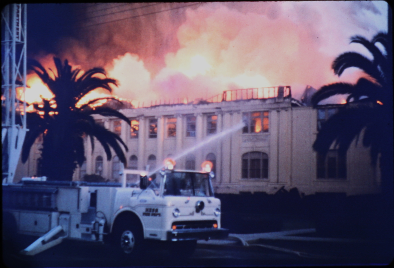

Here's a selection of the results...
Before the fire.
Life before the fire.
On fire.
Fire Department Response.
Reflecting on the destruction.
Inside.
More inside.
Resolve.
As to the quality of the focus, I honestly don't know how much of that is the slides, versus how much is my process to digitize them. Some are surprisingly sharp and I didn't re-focus very often, so I have my doubts about my process being at-fault, but that said, this was my first attempt and I was trying to work quickly.
I will probably work to refine the process, I have some photos of them building the replacement school along with other schools, so I have more to digitize anyway. I intend to get a piece of white plastic to back up the slide with, along with wanting to use stronger light. If improving the process results in better images then I may redo these at a later date.
