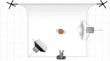

You guys are right, I am being a whiner. OK so i feel like if I don't give him dramatic lighting it looks to "on camera". I also tried to soften the light as much as possible, One light is a shoot through umbrella the other has a 24" softbox and on-flash diffuser. I don't get how it still looks super contrasty and, as pointed out, sh*tty.
How large is the umbrella?
How far away is it?
Is the umbrella the Key or Fill?
A 24" softbox is small for this kind of shot, how far away was it?
What lights are you using?
Diagram please: http://www.lightingdiagrams.com/Creator Distances are very important.. please list them. The highlights in the eyes are tiny.. so either the modifiers were far away, or too small... or you modded the highlights in PS?

Little umbrella, maybe 24 or 25" same as the box, don't have anything bigger. About 5-8 feet away. Box=main, Umbrella=rim using 580exii main and 480exii rim. Maybe beauty dish better? Gonna post another w/o toothy smile later.
Part of your problem is that your lights are too far away. Bring them in. A lot. Have your key maybe 2-3' away and your fill/rim not much, if any, more.

Having them 5-8 feet away pretty much defeats even using them.
I would use 40" or so modifies for a head and shoulders shot, unless you want the lots and lots of 'shadow wrap' (very diffuse, almost invisible shadows) a 60" can provide.
