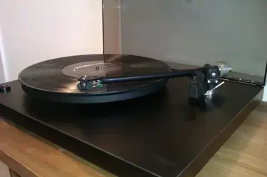

Ive got a nice Pink Triangle turntable

Ive got a Rega, planar 3.

Oh, and my deck :)
