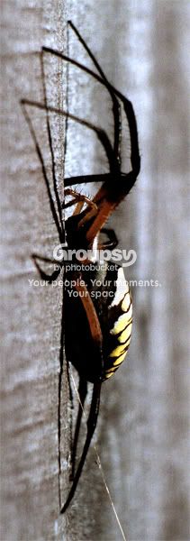

About using tubes...
Here's a scan of an old photo (all I have handy as an example). Sorry, I don't have a clue as to the particulars on this shot except I was using tubes, an N8008 with a 70-210mm zoom hand held and I over exposed a bit.
Hope this helps
mike
BTW, the tubes were under $20
