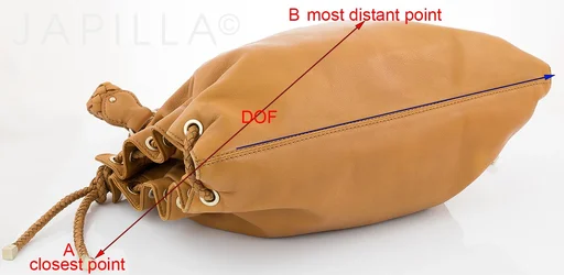

i have been doing it all wrong. If DOF is the same as it is in 3d, then i really understand it. However i'm pretty sure that if I aim at the string grommets to the left of the bag, that the right extremity of the bag at f11 will be slightly out of focus. IN 3D DOF only pertains to depth in a straight line and not right and left.
Let me try a shot now aiming at the left tassels.
A point further to the left or further to the right won't matter, what matters is it's distance from the camera's sensor. So lets say that the grommet is exactly 3 feet away from the camera, and that's what you choose as your point of focus.
Everything that is also exactly 3 feet away on that same horizontal plane will be in focus. Anything that is 3.1 feet away or 2.9 feet away may experience some focus fall off depending on your DOF. The DOF tells you how far away you can move from the plane of focus before your focus starts to fall off, either toward or away from the camera.
Hopefully that makes sense.
Oh, i see what you mean, the left tassels (A) are the closest point (less distant) portion of the bag.
The top of the bag (b) is the farthest away.
That is the DOF (A-B).
So the blue line that I also want to get into focus is irrelevant.
Maybe f11 is way too high then for this pic, because the DOF is pretty small
Actually, the DOF is more of a slight curve, where the plane of focus is slightly curved around the lens, so that every point is equidistant from the lens.
For practical purposes we tend to think of this as a flat plane, but it's actually somewhat curved. A bit like your arm's reach is equidistant from your shoulder, no matter which way your arm is extended.
Get your focus area positioned over one of the grommets, press the shutter button only half way and hold it there while you move the camera to the right to get the entire bag in the frame. If you haven't taken your finger off the button, you may now finish pressing the shutter button the rest of the way which will release the shutter, and the focal plane should still keep the grommet in focus, even though it is no longer directly in the focus area.
The best way to know what aperture to use for DOF is to actually calculate the DOF using a DOF calculator. There is one online that you can use here: Online Depth of Field Calculator
Plug in your variables, such as; camera, lens, focal length, aperture, and distance for find the DOF for that shot.
If the DOF is "thicker" that your subject, then you can take the shot. If the DOF is thinner than your subject, make some adjustments to make it "thicker". Then take the shot.
All of those variables affect the DOF, so you should do that every time you change something.

For this example, the bag appears to be no more than 4 inches thick, at least for the parts that we see. So you will want to make sure your DOF is at least 4 inches, front to back. You would focus on any handy "edge", such as where the handle is attached to the bag, lock focus, then re-frame and finish the shot.
