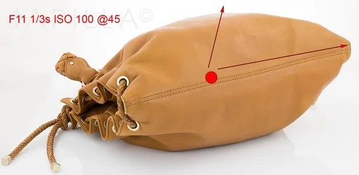

I am very confused about DOF and which direction. I am also very confused about where to place my focus point on a bag. I only shoot the bag in about 8 different positions, so it would be logical to post these positions here and tell you guys where I am focusing. All I know is that F11 is now yielding the sharpest images with the 18-55. I have put the 55-200 away for good.
Here is a picture of a bag. The red point is where I focus. Where would you focus?
I am confused if DOF goes more towards the right? Or does it go behind the bag (imagine a 3d space)?
On F11 i try not to get the whole bag in the viewfinder because I know that the left and right extremities of the bag will be out of focus. On the other hand increasing up from F11, causes blurr.

FYI, further back on your bag example it is being blown out by the lights. detail is being lost due to too much light in that area. Light needs further diffusion.
That one book Light, Science and magic would be of great benefit right about now. (and then some time to read, experiment, understand and use the knowledge)

Imagine the DOF has having some "thickness" in which the acceptable focus will be a range that is divided about in half between "in front of" and "behind" your focal point. This is not an easy thing to do, but with practice you should be able to wrap your head around it eventually.
In the example you posted, I might have tried to imagine the thickness of the entire subject, and then select a spot that is about half way between the front (nearest the lens) and the back (the farthest from the lens). To me, it seems that one of the string grommets could be about half way from front to back, so I would focus on that, then lock focus and reframe to include the entire subject. Before letting go of the shutter, and before the actual shutter release, move the frame over to frame the bag and then complete the shutter release.
Ok, so DOF. To start with imagine a plane that runs parallel to the sensor in your camera. When you focus on a specific point, any other points that are on that same horizontal plane will also be in focus.
As you start moving off that plane, either towards the camera or away from it, the focus will start to fall off and those points won't be as sharp as the points that are on the horizontal plane on which your focus point lies.
The larger your DOF, the further away from the focal point a point can be and still appear to be in focus.
OMG
i have been doing it all wrong. If DOF is the same as it is in 3d, then i really understand it. However i'm pretty sure that if I aim at the string grommets to the left of the bag, that the right extremity of the bag at f11 will be slightly out of focus. IN 3D DOF only pertains to depth in a straight line and not right and left.
Let me try a shot now aiming at the left tassels.
