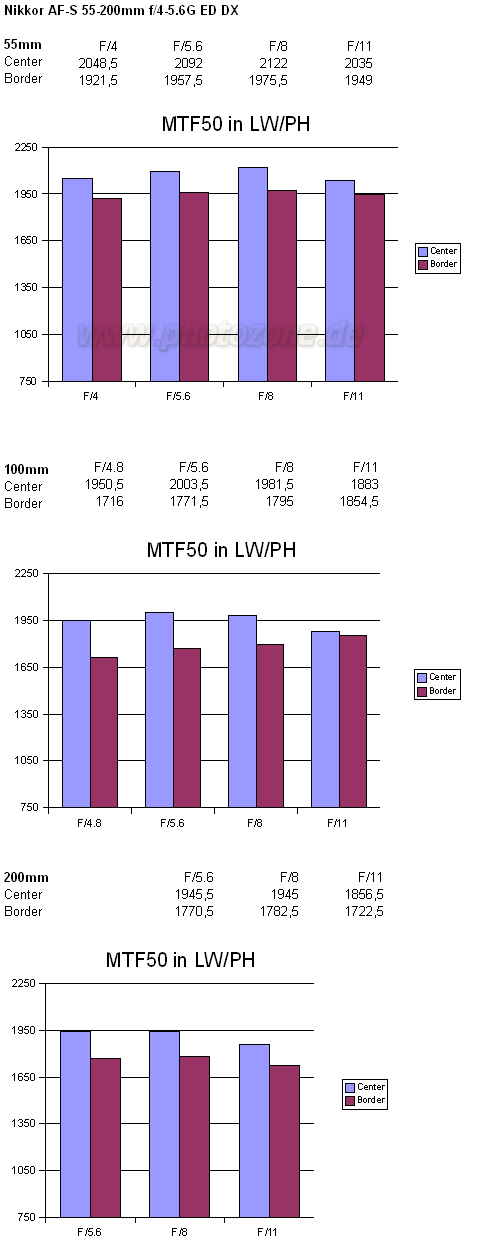

actually doesn't seem to be the case in this lens:
but you can see that f/11 is where this lens is sharpest, the more you stop down from there the softer it's going to be.

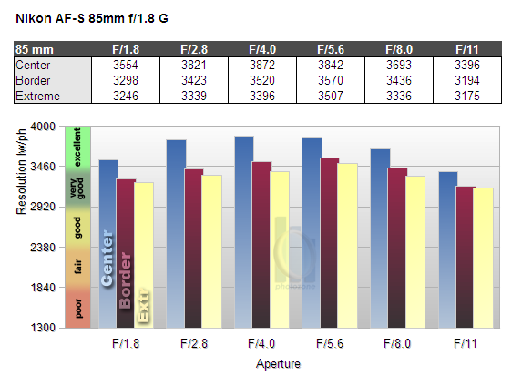

now look at measured values from one of Nikon's best bang-for-the-buck lens:
this measures out to be about double the resolving power.

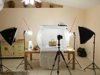

I need to stand back ...bags do not look natural if you shoot them close, normally i stand back 6-10 feet
Here is a photo of my set up. We all understand there is not enough light. My questions is:
Do you see the two unprotected 105 watt fluorescent bulbs in the picture? They are in front of my camera lens. Is this bad? Should they be covered with a box? Will they interfere with my shot?
Do direct lights have to be behind the camera?
but you can see that f/11 is where this lens is sharpest, the more you stop down from there, to softer it's going to be.

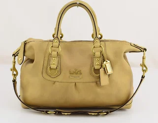

Huge improvement in sharpness
Shot at f8 1/60 and 400-600 ISO
I shot these not at 55mm rather around 40mm.
Ok now we are finally getting somewhere...this is the starting point.
