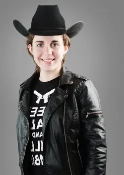

By the way, If you guys can look at a couple more photos, I would appreciate that.
Both of the ones you just posted look really good lighting wise, on par with the wall one above, I like them a lot in that regard.
The cowboy hat one I like overall a lot. She looks confident and interesting and in a good mood and the angle is nice and everything. The blue dress is less flattering due to a not-so-happy expression and a very closed/defensive posture

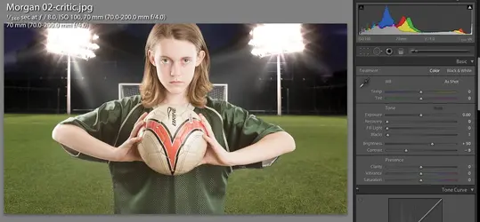

How about another photo,
I like this one better than the earlier shot. I brought it into Lightroom and looked at it for a couple of minutes and adjusted the exposure a bit, moved the tint slightly, added some contrast, boosted the clarity, and burned down the lower corners to add more emphasis on the player, and to simulate fall-off from the stadium lights. I tried to make it look as "real" as I could. What do you think?
.webp
Derrel,
That looks much better than the original one!!!!! Thank you so much for the editing. I did not know how to improve the photo. But now look what you did.
I rarely change the tint once I set the white balance. What made you to change it?
I would love to see a picture of your lightroom pannel of how much you changed for each option, I have several other photos like this would love the same treatment.
Julian
Sure, here are the before and after Lightroom panels you asked for.
Here is the image with the defaults, as shown first.
And here are the Lightroom basics shown; the burning down of corners is not reflected in the changes, obviously.
.webp
Did you flip the cowgirl image horizontally or does her shirt just read backwards. Also the blue dress one I thought was great but thought her hand should be facing downward. Her fingers curled upward is a but distracting to me.
In regards the first one.
He is almost swallowed up by the background. There is lots and its bright.
In regards the subject, his suit is dark so pretty much what stands out is his shirt and the horm.
I would suppress the background, lighten his suit so he actually becomes more visible and crop it to make him larger in the frame.
Good eye, yes I did flip her horizontally as I prefer this way.
