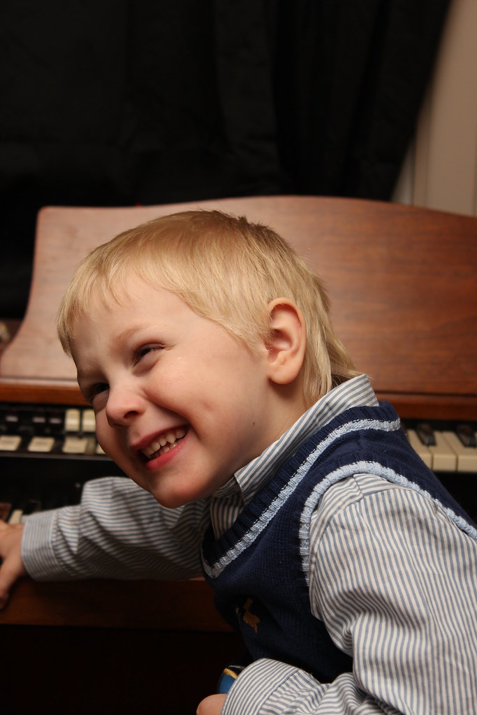

And number 5 could use a little improvement in composition and probably a full stop more exposure to get some eye color going... I would have flagged most of the key light off the piano and added a sharp rim light from camera right with a small bounce to expose only a portion of the piano, leaving the rest of the frame black.... an improvement in composition would make that choice more sensible.
Primarily ... composition.
The moon, clouds, and stars don't seem to fit together. You probably better off just with the Moon ... or stars.
The portraits suffer from both composition and lighting.
Too much dead space on top and body parts cut out. The illumination does not compliment the subject.

4. Body parts cut out, which was my first thought as well. Unfortunately he's a squirrely subject. Less head room. Better lighting (was my first attempt with an external flash...580 exII) Now that I have a flash, I'll start perusin the strobist website. In the meantime, in what way exactly does the illumination not comliment the subject?
5. Same as 4.

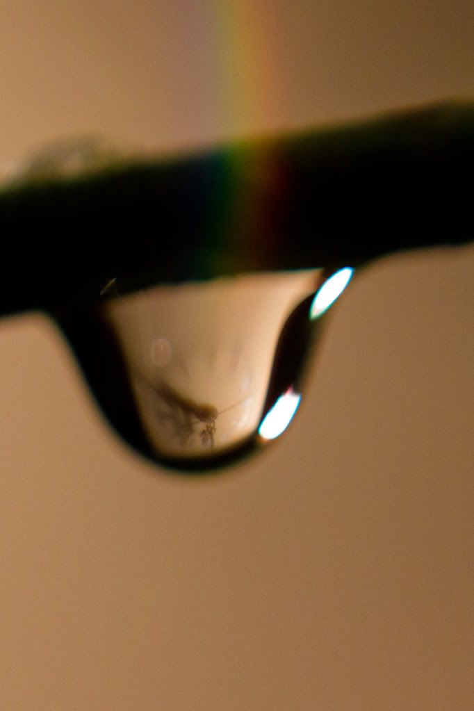

Or you can use the lens flare to your advantage, as here:
(It's a clock refracted in a drop, it's not very clear and I would need to reshoot that one)
Huh, that IS a neat effect. Was it intentional or accidental? If it was intentional, how did you predict it?
It was accidental. I was using a technique called "Free lensing" whereby you hold the lens in your hand. Holding it further away from the Camera body gives closer focus. Tilt for DOF effects.
You can predict Lens flare to a certain extent, strong light shining straight into the lens or just off to the side.
