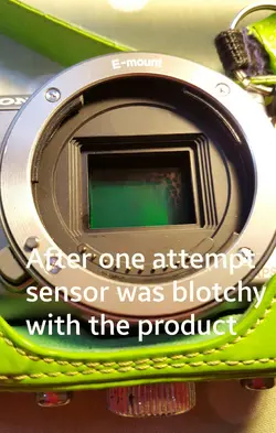

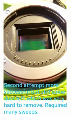

Hey everyone, Just thought I'd give an update, so have attached pictures and text-on-the-image of the product that I used , which got rid of the smear on the sensor of my sony nex5T - YAY!Thank you all for your help - now I know there is such a thing as sensor cleaning kit!

My favorite camera flings OIL...so when I clean its sensor, it usually takes FOUR swabs. Other cameras I have had never flung oil, so they could be neatly done with one, or two swabs. Congratulations on your act of having taken this bull right by the horns and wrassling it into submission! You've now got the camera back to working order and have not sunk 300 pounds Sterling into it. Way to go Zoe!

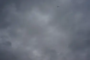

I think I'm about to write off this camera. I have no idea what's going on and why I cn't get the sensor clean.
I will post up five images with this camera, straight out of cam with no levels-editing, to show the crazy, varied, but always bad results. dirt/crap comes up different places on the images??this is as seriously clean as I could possibly get the lens and sensor to be. I can't clean anymore.
Shot at ISO 100 at F22 shooting up at the sky, ,moving the frame of view slightly each time. All shot within seconds (or less) of each other.
