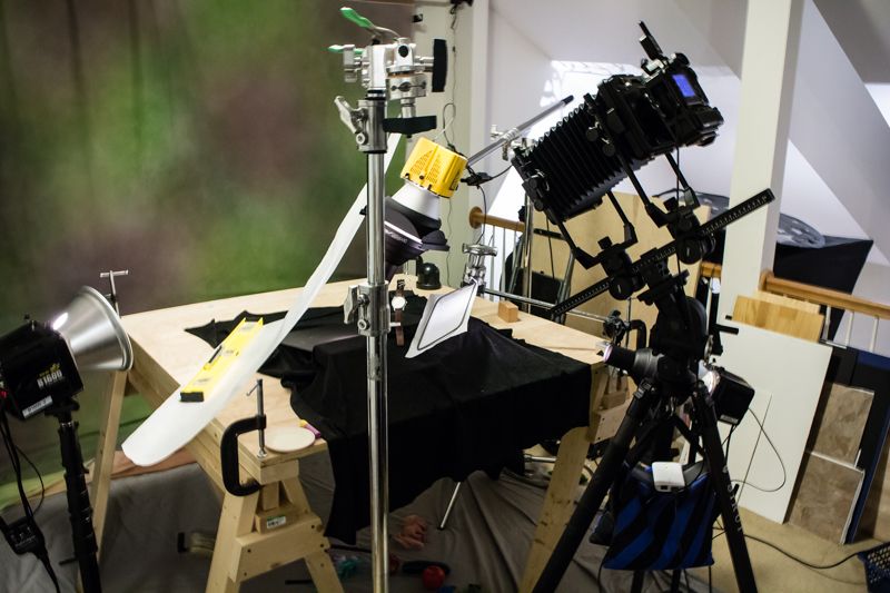

Personally, I ended up getting the Sirui R4203L for studio shooting. It's ridiculously stout and quite well built for the money. As you can see, it can handle anything DSLR related that you can through at it:
That 4x5 camera is heavy, yet the tripod is rock solid. That Majestic head isn't exactly svelte either. ;) That 4x5 alone weighs more than my 600 4.5 and the gimbal head. Then add the Majestic geared head, which is quite a beast itself, then the sandbag, then hang it all precariously off the side of the tripod at an odd angle, still solid. :)

I only do this as a hobby and I can't justify spending $500 on a tripod as much as I would like to. :) You have a very nice set up and the tripod looks very sturdy.. My max budget is $300, so I might look around Craigslist and Ebay to see if I can get a good deal on a used one. Thanks for the information!!
