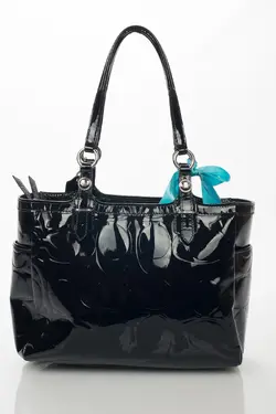

I would start by placing one light on each side about 50-60 degrees off of lens axis and quite close to the bag (reducing output as necessary of course) so that what you have is a broad ellipse of light hitting the bag from each side. I might also try a polarizing filter to see if that helped.

this was two lights here at a 30 deg angle. But they are high up looking down.
It was shot at s 1/100

Okay, that's considerably more of a PIA because of how reflective it is, but it's doable.
is this correct?
Both lights are close to the bag.
Is the angle correct?

I would move the lights so that the vertical part of the stands are touching the edge of the table and rotate them so that the light is flowing almost parallel to the face of the bag.

Angled them on the side and this is what I got. Front of bag is dark

Okay, so start bringing them back toward the camera. Don't forget your presentation; there's a nasty wrinkle/dent in the left bottom corner of that bag.

well.. i think for this frontal shot the ceiling works better.
Now I have to give the bag a tad more light in front. Maybe ISO 200. I have no reflectors yet...have not gotten to that stage...Duh!
This is the sort of bag you would give to your worst enemy to photograph..."Go! do it and come back when you succeed", you would probably not see him for the next year.
