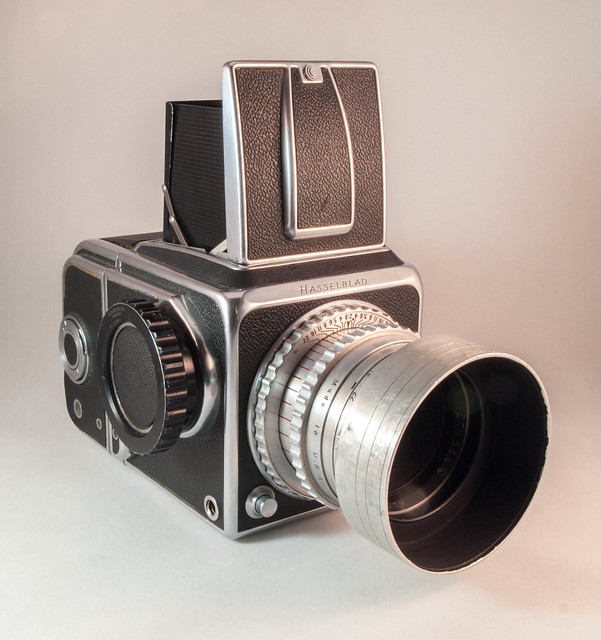

Hey guys. Yesterday, I got myself into the MF world for real this time. I'm now stuck with a Hasselblad 1600f of my own, since the slow speed shutter mechanism needs some work. The clockwork is all kinds of slow and sticky and needs a good lubrication, and if I ever get the guts, I'll fix it. Basically, as long as I don't need anything slower than 1/25, I'm good. Here she is:
PC122543 by longm1985, on Flickr
