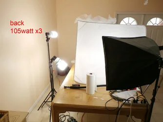

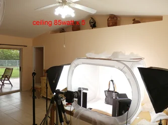

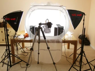

Here is my current set up. I just realized i could place the LED panels inside the tent, so they are very close to the bags. This is going to change the the whole S value, I can now probably increase to 1/100 at least.

..I just learned that the F stops let in more or less light..
That right there illustrates why we are so frustrated at trying to get you up to speed. You're still in neutral. How can you gain any traction that way?

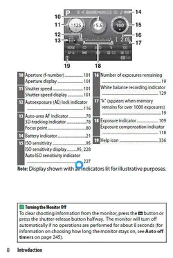

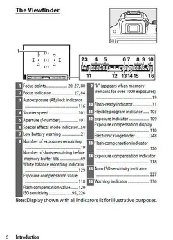

Meter? Where? is it a device i have to buy? Or is it in my camera already? Is it called an exposure meter?
Yes exposure meter

# 12 below
#18 below
