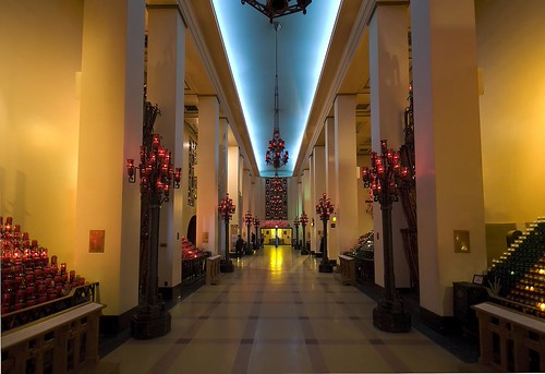

PS
This was taken with a lens equivalent to about a 14 mm shift lens, but it could just as easily have been taken with a wider lens (or a zoom at a wider setting) then cropped. There has been no perspective or distortion correction in Photoshop.
