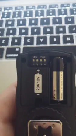

On the underside of each unit, you should see four DiP switches; the settings on these have to be identical for XMTR and RCVR.

The button on the camera-mounted transmitter fired the flash. Here are pics of what I assume are the "DIP" switches you spoke of. How should I proceed?
Okay, then the switches are set correctly already. Will your camera fire the flash when it is in the camera's hot shoe?
